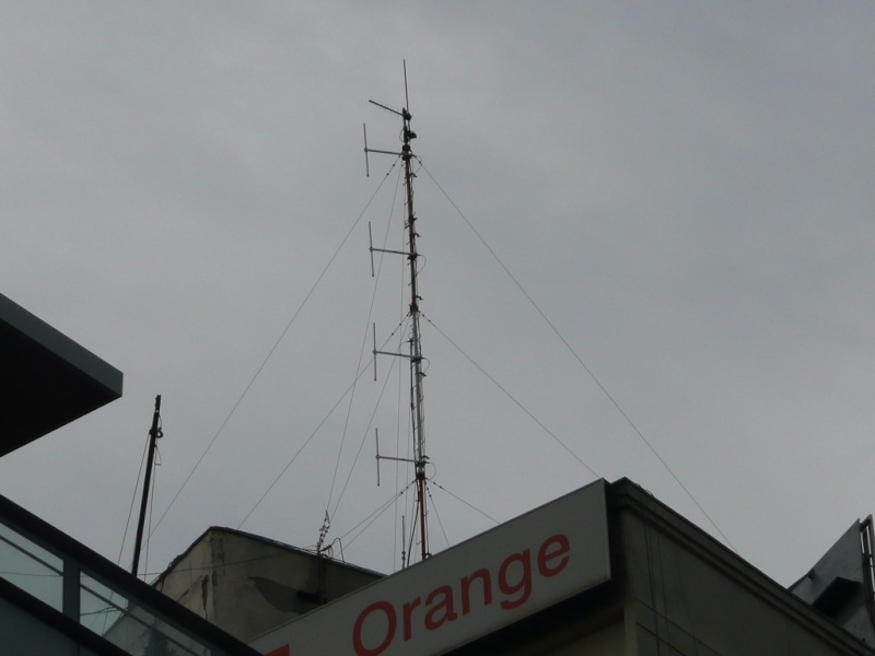

http://www.frocus.net/images/antennas/ro/B...08/gotile10.jpg zboaro la gueirla realitatea gold ..
http://www.frocus.net/images/antennas/ro/B...08/p1030310.jpg la fel la gorila cu ea ... nu la piata presei libere !
#30005 - scrie 106.2 / 99.3 / 92.7 / 105.8 / 107.3
#30004 - CANAL MPX 59 si nu 54
#30000 = canal 30MPX si scoate canal 59Mpx
http://www.frocus.net/images/antennas/ro/B...ti/antena11.jpg asta e antena cu 107.3 / 105.8 / 106.2 / 99.3 tzi-am scris mai sus dar tu esti foarte superficial la info
